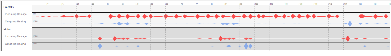

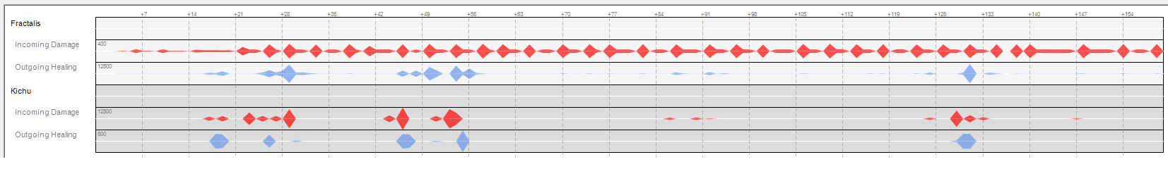

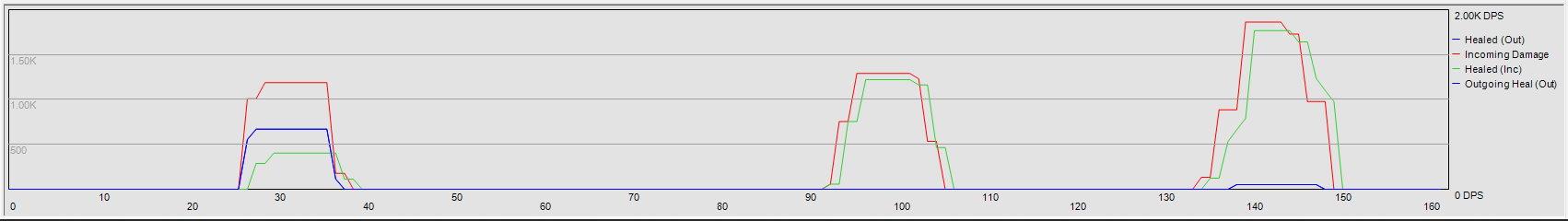

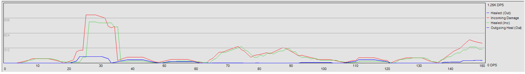

Here are some charts, taken today from the point of view of the tank. They record incoming damage and heals on the tank, including self-heals. DPS are out of the picture, and only part of the total healing is shown: the part that was directed to the tank.
Some of the fights were not recorded properly and are kept out of the data.
Bunica Padurii, fights 2 and 3

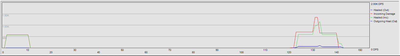

Kemementi the Fear Eater, fights 2 and 3:

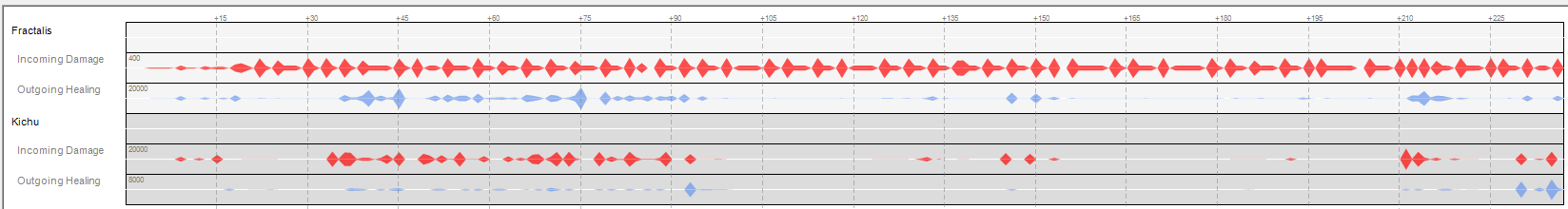

The Abyssopelagic Horror, fight 1:

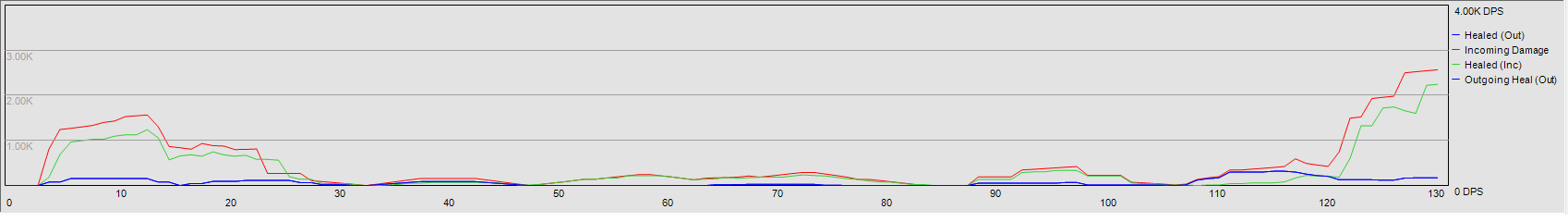

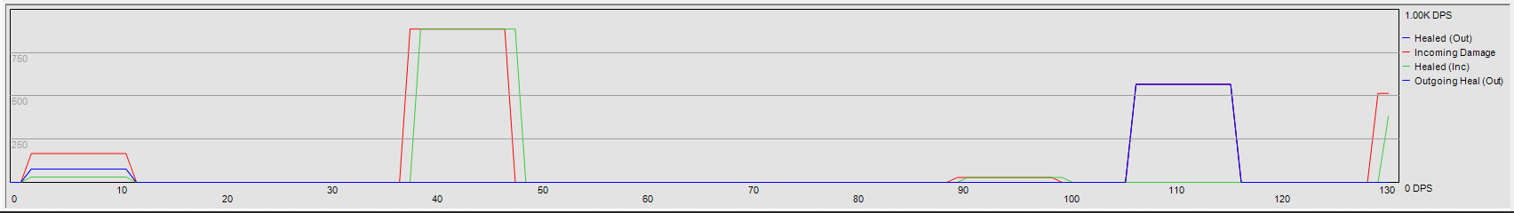

The horizontal axis is the time in seconds since the start of the fight; the vertical axis is the amount of DPS or HPS at each time. The blue curve shows the self-heals, the red curve the incoming damage, and the green curve the external heals (from the healer).
Re: Did it hurt?
I think these graphs are really interesting.
That damage increases at certain points in the fights is clear - we know when the tank should be interrupting, when to cleanse, when not to be knocked back etc. The fight duration and when these things happen based on how much dps is being aimed at the bosses.
Did you run different cooldowns at the start of fights for BP2 & 3 Kichu? Was the raise in the middle due to DPS taking longer to attack the spirits? BP can hit like a truck.
Was the second peak in graph KF2 due to a missed cleanse for Word of Anubis?
I am not sure I understand why the outgoing heal was so high in KF2 peak 3 compared to incoming damage on the tank?
Do the peaks in graph AH1 correlate with the AoE casts?

Katelin wrote: ↑Tue Aug 09, 2022 1:53 pm Did you run different cooldowns at the start of fights for BP2 & 3 Kichu? Was the raise in the middle due to DPS taking longer to attack the spirits? BP can hit like a truck.
Basically, I'm forced to use different CDs on every "branch swipe", because my CDs are quite long, still. I use Juggernaut and Pain Suppression + Unification Susceptibility Module gadget (as a helper). Although, once (not today) I managed to through the entire fight without getting bleed at all, which was really surprising for me - maybe the Paduri didn't roll good dice for the damage, too :-) The HPS was something like 350, which made me to question the correctness of the data :-)
Katelin wrote: ↑Tue Aug 09, 2022 1:53 pm Was the second peak in graph KF2 due to a missed cleanse for Word of Anubis?
Shouldn't be. I didn't get knocked a single time during the entire fight, as long as I remember. Most probably this is due to my mistake.
Katelin wrote: ↑Tue Aug 09, 2022 1:53 pm Do the peaks in graph AH1 correlate with the AoE casts?
Most probably... I use DefCD on every single one AoE + the Osmium Configuration, but still it is a lot of damage. In general the Horror tend to be a little bit chaotic, especially in the beginning of the fight - sometime even with DefCD he manages to trigger my "Die Hard" with the very first hit on me.

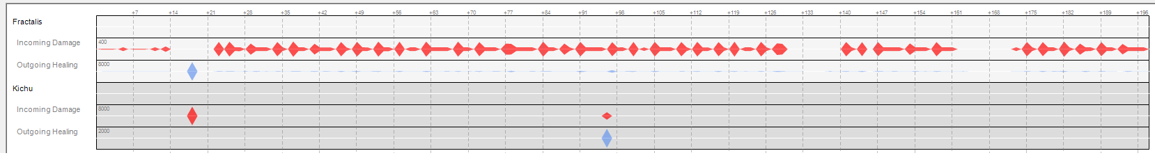

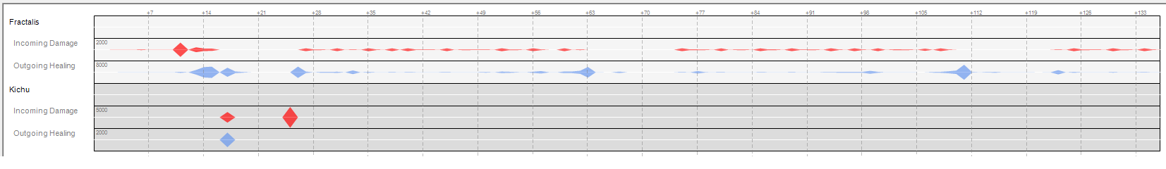

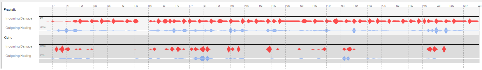

Here are some graphs for some of today's fights, showing incoming damage and outgoing heals for both the tank and the healer. Outgoing heals for the tank are self-heals, and incoming damage for the healer is Martyrdom. Each graph's scale is different (look at the numbers on the left to see the magnitude).
Bunica Padurii 2
Bunica Padurii 3
Re: Did it hurt?

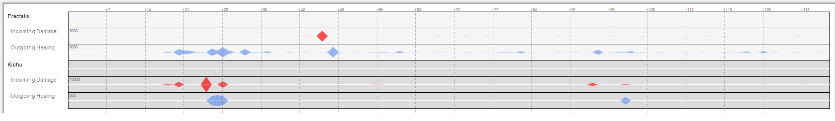

Kemementi the Fear Eater 2:
Here the bigger patch of damage on the healer is a mummy curse.

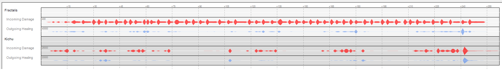

The Abyssopelagic Horror 1:
Re: Did it hurt?

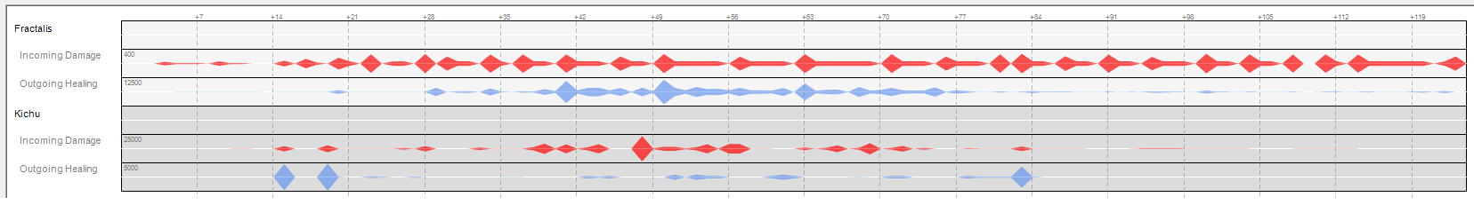

Bunica Padurii: today she didn't like the tank
Re: Did it hurt?
